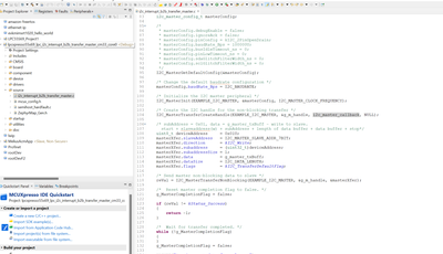

Hi @sushmasan
I think you can refer to the  lpcxpresso55s69_lpc_i2c_interrupt_b2b_transfer_master_cm33_core0 SDK demo.
Harry
