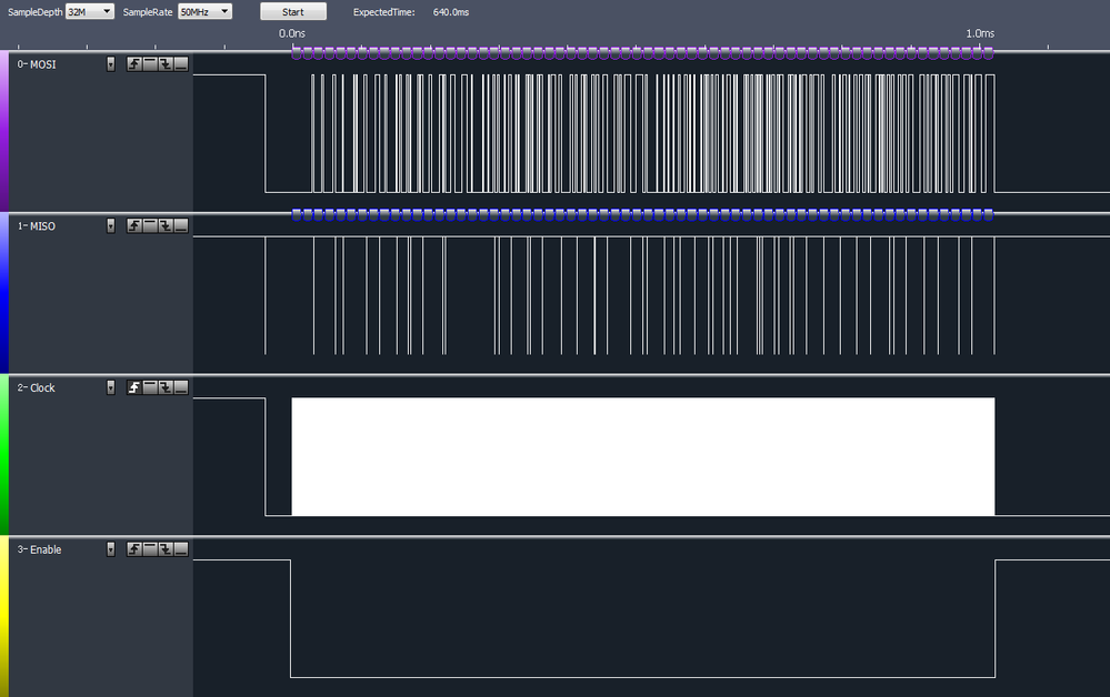

I want to read/write SPI SRAM by LPC54608
I want to use Interrupt,non-blocking.
I attach a qutestion.
Please answer my question.

Hi Customer,
   You can use the interrupt mode, it's no problem.
   Now, answer your question:
 Take the sdk code SDK_2.3.0_LPCXpresso54608\boards\lpcxpresso54608\driver_examples\spi\interrupt_b2b\master as an example.
  The SPI wave is tested as this:
The CS will be de-asserted after the last byte is sent by the interrupt.
More details, you can check SPI_MASTER_IRQHandler in spi_interrup_b2c_master.c.
Wish it helps you.
Kerry
