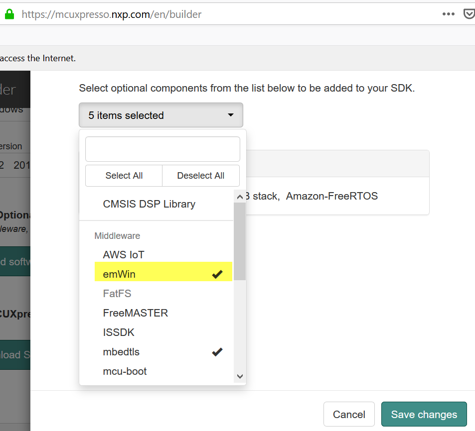

There is emWin demo code included in LPCXpresso55S69 SDK, make sure you select emWin component when download SDK.
demo is under folder:
SDK_2.6.x_LPCXpresso55S69\boards\lpcxpresso55s69\emwin_examples
Hardware requirements
- Micro USB cable
- LPCXpresso55S69 board
- Adafruit TFT LCD shield w/Cap Touch
- Personal Computer
Hope this helps.
