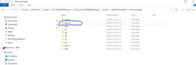

There is EEPROM example in SDK package for LPC8N04, pls refer to it.
You can download SDK from the link:
https://www.nxp.com/design/software/development-software/mcuxpresso-software-and-tools-/mcuxpresso-s...
Hope it can help you
XiangJun Rong
