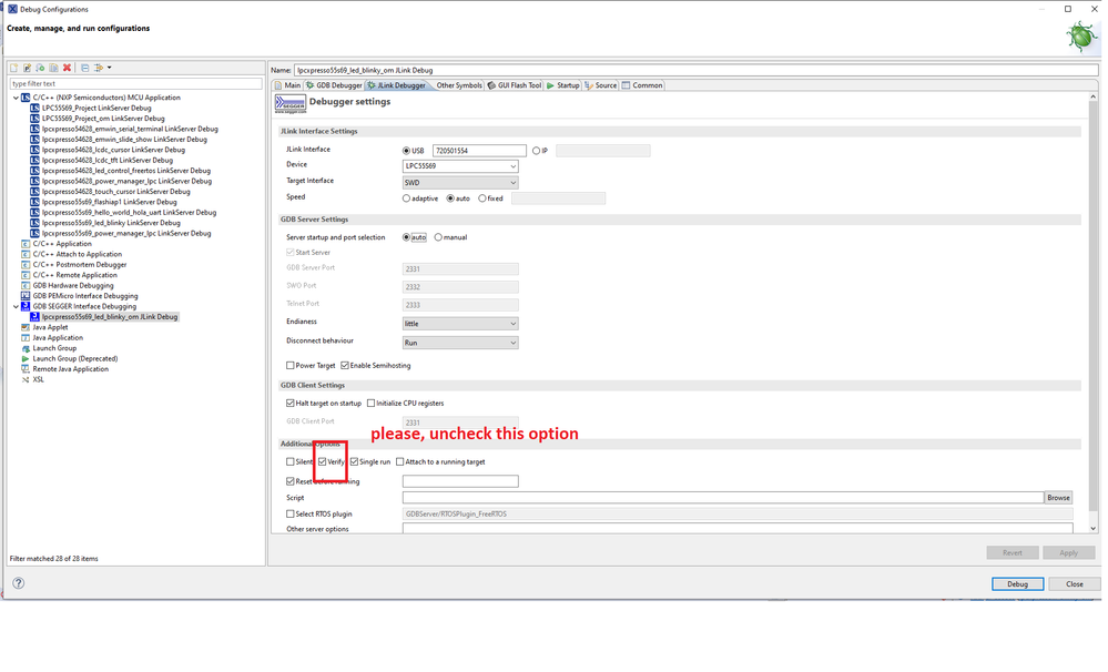

hi , i want to disable jlink to read back my bin from Flash,how can i do it.
1,669 Views
diego_charles
Hi caibai‌
Sorry for the delay!
To provide an useful reply, could you help my with the following inquires?
  •  1 After flashing the MCU, the J-link firmware will read back the  what was previously written  . You are refering to this process and you want to disable this read back?
  •  2  Your debug tool: on-board debugger,
  • 3  Are you using J-link tools on a production environment or  an IDE like MCUxpresso ?
If the answer for the first question is yes, and you are using MCUxpresso,
you can uncheck the verify box Debug configurations for JLink, (green bug options)uncheck.png. Best regards, Diego
