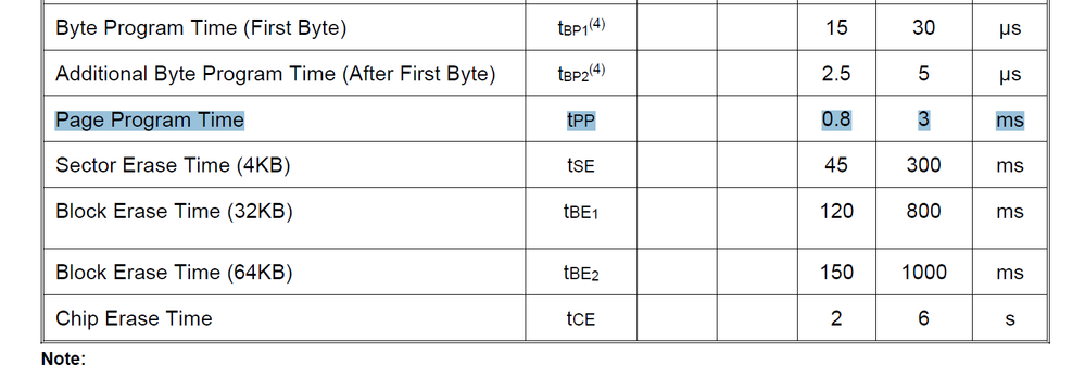

xiangjun_rong
Hi, Navid,
I do not think your solution is feasible that you want to save samples into on-board spi flash. I copy the specs of W25Q80, the page program time(256 Byte for one page) is 0.8mS, 1024K bytes take 0.8mS*(1024K/256)=3.2S to program  into flash. But acquiring 1024Kbyts samples just takes 1/60S=16mS.
In conclusion, it is not feasible to use SPI flash as a buffer to save samples.
Hope it can help you
XiangJun Rong
