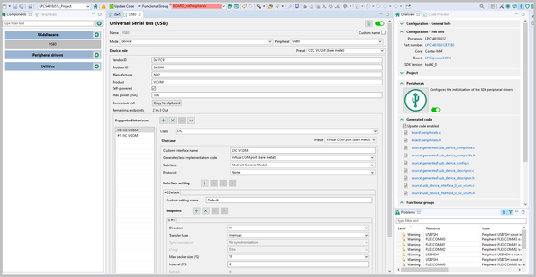

Below some images of the testing that I have done, using SDK_2.7.0_LPCXpresso54618 and MCUXpresso IDE v11.2.1 [Build 4149] [2020-10-07]
My peripheral settings for USBFS , yet I have not replicated your error.
My peripheral settings for USBHS, yet I have not replicated your error.

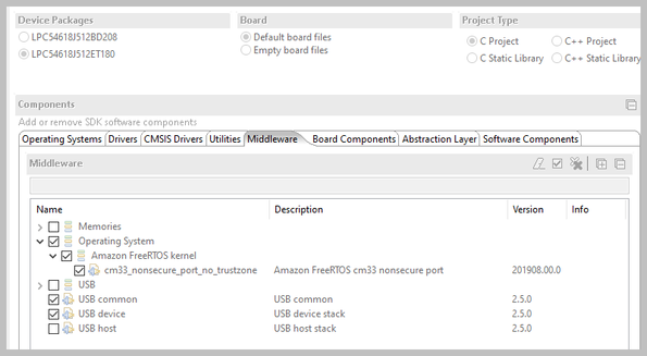

After importing your project I was able to get the errors that you are making reference to, even tough the tool is able to generate code , the tool was able to generate USB code , and I did not find compilation issues from my side.
Unfortunately I was not able to replicate the errors that the tools shows  while creating a project on my side using the same MCUXpresso 11.2.1 version , thus the same Peripherals tool . Please find my project attached . Let me know if works on your side or If I missed any configuration or driver.

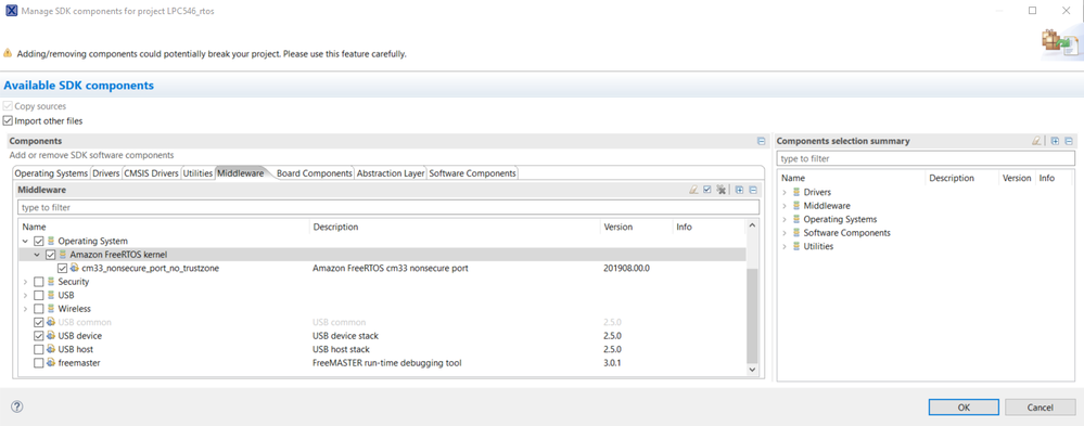

Could you please help us to verify that you  have the USB drivers  already imported in your project?
If  not , you could add them using the function Mange SDK components.
Please refer to chapter 7. SDK Project Component Management of the MCUXpresso IDE user guide.
If you still can not found the USB drivers in the Component management window.
Maybe , your  SDK build did not include the USB drivers. In that case you can uninstall that
SDK , build a new one , and install it.
