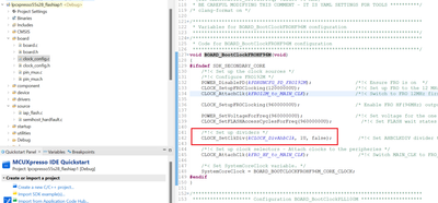

Harry_Zhang
Hi @Folkert
I checked this demo.
I found that
CLOCK_SetClkDiv(kCLOCK_DivAhbClk, 1U, false);
So the  kCLOCK_BusClk is the same with the  kCLOCK_CoreSysClk.
And i print them. they are same.
You can tested it.
Harry
