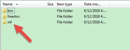

allevato_loris
Dear jeremyzhou,
I tried with the 2.5.0 version of the SDK but Windows 7 does not recognize the USB port, do I have to install any driver? If yes where can I find it?
In my application I have to send data (strings) from the board to the pc, it could indicate the most appropriate example from which to start.
Thanks to the availability
With regards
Loris
2,382 Views
jeremyzhou
Hi Loris Allevato,
It exists an inf folder in USB CDC demo's directory, and in that folder, it contains the driver file, please check it.
TIC
