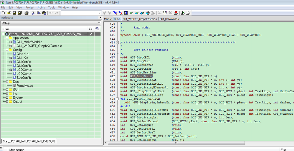

hello,
I have a problem with adding the emwin library to my workspace in IAR.
I downloaded emwin from nxp and segger but I have a lot of error of "no definition for files" such as GUI_Init,GUI_Dispstring and GUI_Delay.
I read the user manual for emwin5 and it says about paths like GUI\Core and GUI\Font but I can't find it.
Arent they exist in the trial version of emwin?where is the problem?please help

Hi mino,
    You can check this post:
Code issue solutions in emWin_mcb1700_bsp
   I already attached a sample code for LPC17xx, this code also have the IAR project, it builds with no error,
   All the GUI_Init,GUI_Dispstring and GUI_Delay can be find in GUI.h.
Wish it helps you!
