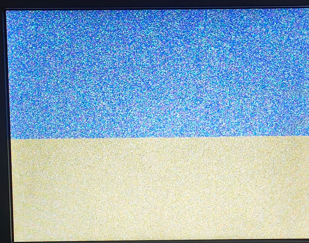

Thanks for your reply and  we have downloaded the  emwin sdk for lpc546xx and integrated the emwin libraries in our project  currently we are facing the issue of  in the GUI_init();So  far we have  not used the debugger in our project and we are using the uart for verifying the program flow .
as per program flow:
GUI_INIT----------------->LCD_INIT-------------->Hung or may be in hardfault exceptions.

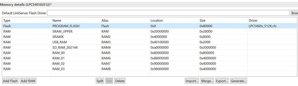

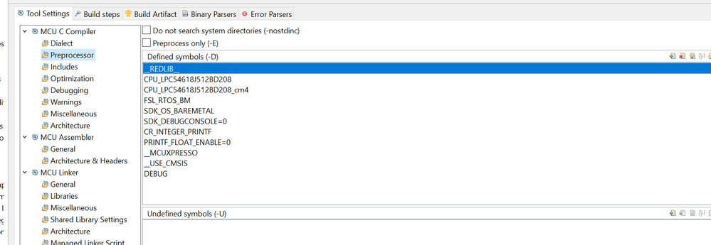

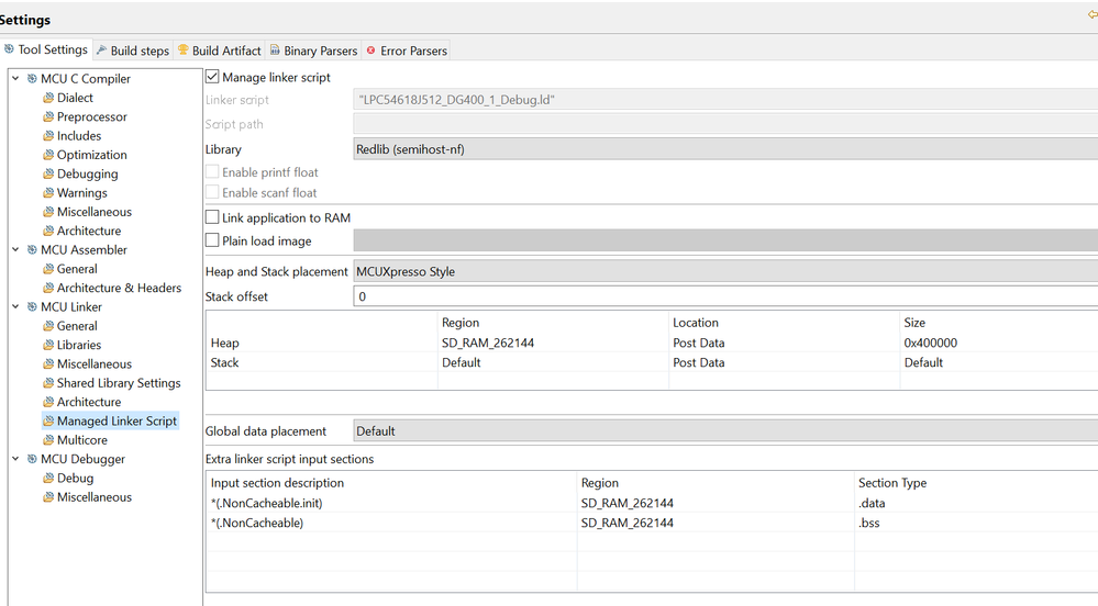

We are using the external ram for storing the display buffer and gui buffer .Please go through the images i have attached for your reference.
We ae using tianma lcd part number TM104SDHG05

///V_RamframeBuff size  is 960000 bytes  and allocated in external ram

      ///GuiNumberofBytes size  is 2MB and allocated in external ram

we are using 800X600 10.4 inch lcd
Please help us to resolve the problem
Managelinkerscript.pngManagelinkerscript.pngMemoryDetails.jpgMemoryDetails.jpgPreProcessors.pngPreProcessors.png
Please help us to resolve this issue as soon as possible because I am  already lagging too much on time
