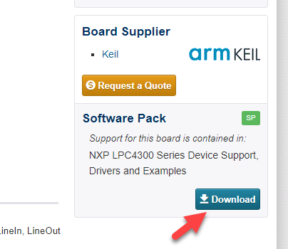

For Host, Keil provides USB Host Mass Storage example.
Customer could check related project attached.

4,158 Views
ssudhir
Sol, Can you please resend - For Host, Keil provides link? The link you
sent gives the following error message.
The previous page is sending you to an invalid url (http://
/external-link.jspa?url=http%3A%2F%2Fwww.keil.com
%2Fboards2%2Fkeil%2Fmcb4300%2F).
If you do not want to visit that page, you can return to the previous page
<https://www.google.com/url?q=http:///external-link.jspa?url%3Dhttp%253A%252F%252Fwww.keil.com%252Fboards2%252Fkeil%252Fmcb4300%252F&source=gmail&ust=1554824203722000&usg=AFQjCNHyYrQCjduddT26J0a2po14i2EGWA#>
