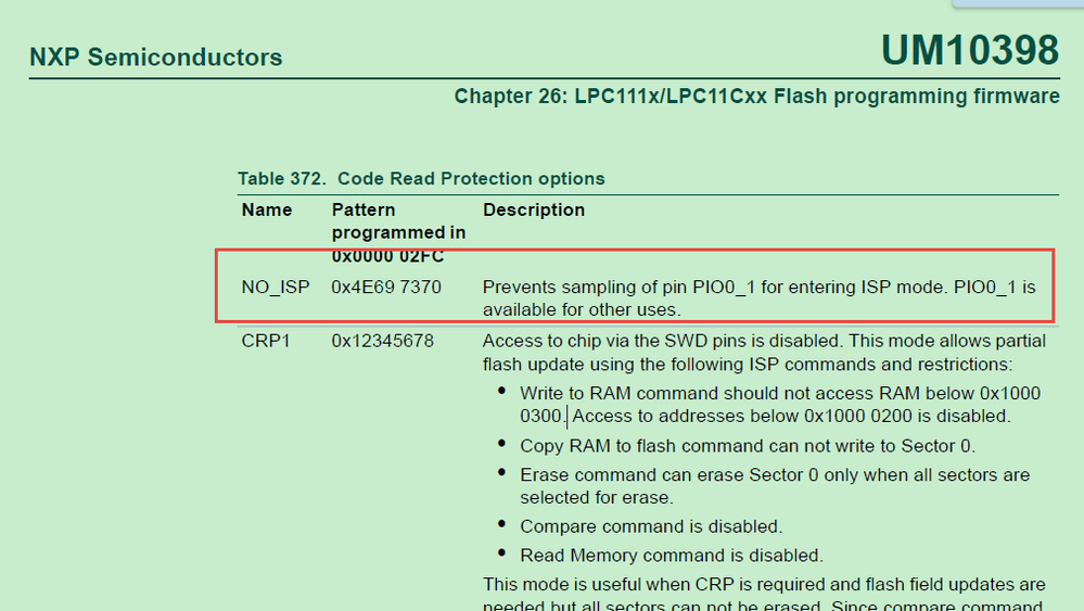

I need to use PIO0_1 as input, how I can disable the function program when reset. If this pin low (0) the LPC enter in mode programer, I want that PIO0_1 low, the LPC enter in normal mode, not in programer mode.

LPC1114FBD48/303,1
2,114件の閲覧回数
kerryzhou
Hi Marcos,
     Thank you for your detail information.
     If you want to disable the PIO0_1 ISP function, just configure the CRP mode as NO_ISP by writing data 0x4E69 7370 to flash address 0x0000 02FC.
    You can find this description in the user manual Table 372. Code Read Protection options.
Wish it helps you!
