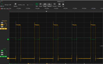

I am trying to implement complementary PWM with dead-time for UPS application.
But as you can find in attached image dead time is working but not getting complementary PWM with this.
I am attaching Source code Please check and support me to solve this issue.

I tested your project on my side, find the issue,
Please change
/* SCTimer output 1 mask */
#define SCT0_OUTPUT_1 (1 << kSCTIMER_Out_1)
to
#define SCT0_OUTPUT_1 (0 << kSCTIMER_Out_1)
Then it can work well, below is my test result:

mohit2904
Dear Alice,
            Thanks for your response please find the attachment for MCUXpresso peripheral tool settings and also find my complete project file and confirm what is issue exactly to getting complementary PWM in my case.

Hello @mohit2904
Please change
to

mohit2904
Thank you @ Alice_Yang !!!
For your support it is working now after doing changes suggested by you...
