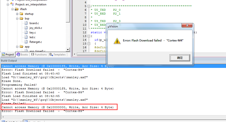

lpc4353 flash download failed
Is it damaged?

Hi sky sky,
for the opportunity to serve you.
Whether the MCU can enter the ISP mode successfully, if yes, you can use the Flash Magic to erase the flash completely to unlock the MCU.
Hope it helps.
