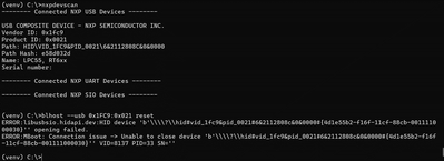

Hello
After updating to Windows 11 is blhost is unable to open USB HID Device.
Tested on LPC55S69-EVK.
Example blhost command:
LPC55S69 Boot-HID device is found/enumerated correct by PC:
Exact same command works fine on PC running Windows 10:
(Same PC hardware / USB connection - Windows 10 PC running as virtual machine).
Question: Why does blhost not connected to LPC55S69 bootloader when running on Windows 11 PC?
Regards Knud

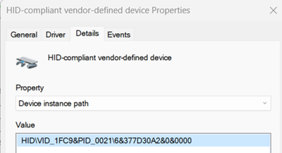

We are facing the same problem. We have blhost working on two different Windows 11 machines:
 PC1
Edition Windows 11 Home Single Language
Version 24H2
Installed on ‎20/‎07/‎2025
OS build 26100.6899
Experience Windows Feature Experience Pack 1000.26100.253.0
PC2
Edition Windows 11 Pro
Version 24H2
Installed on ‎2/‎13/‎2025
OS build 26100.4946
Experience Windows Feature Experience Pack 1000.26100.197.0
However, it is not working on the next machine:
PC3
Version 24H2
Installed on ‎24/‎4/‎2025
OS build 26100.6899
In summary, comparing PCs 2 and 3, it seems that it is the bild version that breaks blhost. However, comparing PCs 1 and 3, it seems to be the OS version (Home vs Pro)

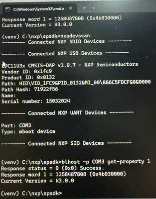

Pavel Hernandez (NXP Support) does no recommend to use blhost
Pavel says that SPSDK work fine on his Win 11 setup, but it does not work on my Win 11 PC.
SPSDK also require installation of Phyton interpreter, which is to complicate for use in our product Service center.
I am still very interested in using blhost on Win 11 - maybe you are able to find solutiuon

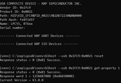

Pavel_Hernandez
Hello, I did the test, and this is my result.
Pavel_Hernandez_0-1714753540897.pngPavel_Hernandez_0-1714753540897.pngPavel_Hernandez_1-1714753551052.pngPavel_Hernandez_1-1714753551052.png

Hi @Pavel_Hernandez ,
I am facing the similar issue. I am using the MCUBootUtility to program the board using OTA bootloader. The bootloader was working fine previously. But now when I try to connect using the BootUtility tool it is giving the following error ' Failed to ping SBL ISP component, Please double check it is SBL target!'.
I can see the USB is enumerated as HID but not able to connect to SBL. Your quick help on this is highly appreciated.
Thanks.
14,913件の閲覧回数
kt
Hello Pavel
Thanks a lot for fast response
Have installed SPSDK, but have more or less same problem – see screen dump below:
  • nxpdevscan command is able to find LPC55S66 device.
  • blhost command is not able open communication (here for a simple reset command)
But, I am looking for a ‘simpler’ tool than installing Python interpreter + SPSDK package – here blhost.exe is perfect.
Need the tool for 2 purposes:
  • In production line for flash programming, read out of UUID, etc.
  • For firmware update at consumer customer / product repair center.
    For this, I need simpler tool than SPSDK
Questions:
  • Is my problem related to Windows 11 or do I have to look for other issues?
    If yes: When can I expect an update of blhost.exe that run on Windows 11?
  • Does other simple program for firmware updating LPC55xxx CPU via USB exists?
    If yes: Any suggestion to fix my problem…
PS.: Same problem on LPC55S69-EVK and LPC55S66 used in our application
Regards Knud

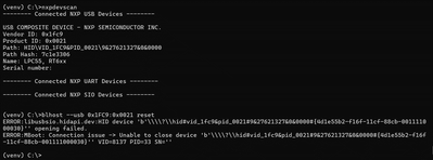

14,905件の閲覧回数
Pavel_Hernandez
Hello, I tested it on my side and then had the same issue, but then I saw you miss a 0 on the PID section, try with 0x0020.
Let me know if the issue is still there.
Pavel
14,900件の閲覧回数
kt
Hello Pavel
Again, thanks for your reply – very appreciated.
Have made 2 new test with correct PID parameter:  No change / same problem
kt_0-1714068985565.pngkt_0-1714068985565.pngkt_1-1714068998365.pngkt_1-1714068998365.png
Knud
14,889件の閲覧回数
Pavel_Hernandez
Hello, did you put the Board in ISP mode?
I test it on my side with the LPC55s69 with the HS-USB (P9) and the ISP button (S1).
Pavel
