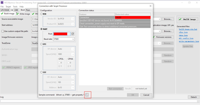

ZhangJennie
Yes,  "MCUXpresso Secure Provisioning Tool" is the only GUI tool for firmware updates via SPI. This tool acctually calls sequences of commands, for exmample blhost command.
we can see what commadeds are called in log file. See below screenshot to enable it
Then we can try to communicate the target with those command in command line window.

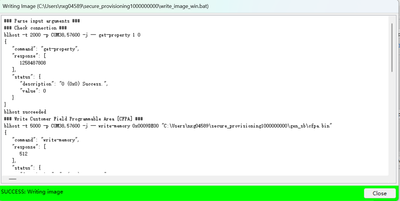

ZhangJennie
Hi Samhan
When you have board setup with the instructions of article, you will see command sequence if programming successed.
below screenshot is ISP programming via UART.  If via SPI, you can get similar as below.
Please try ISP SPI mode with SEC tool, make sure it works, then check the sequence in log file. You will see how blhost command works.
