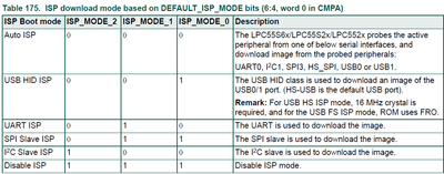

Make chip into ISP mode before  using SEC tool connect. When power-on, BOOT ROM determines whether enter the ISP mode, based on the CMPA configuration in bit DEFAULT_ISP_MODE and ISP pin status. As shown in  following tables
Keep the default value of EFAULT_ISP_MODE to “000”, and enter the ISP mode by pulling down the ISP pin PIO0_5. The first valid probe message on USART,
I2C, SPI or USB locks in that interface. On LPCXpresso55S69 development board, connect the ISP interface cable (USB\UART\SPI\I2C), press and hold the ISP button, power on,  it will  enter ISP mode.

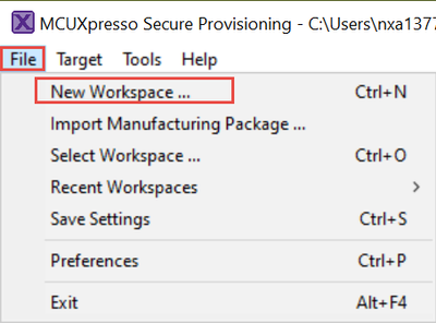

3Configure MCUXpresso Secure Provisioning Tool: select USB connection mode, test connection.

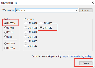

First, click "File->New Workspace", open the option to create a new workspace, and select the processor model you are using.

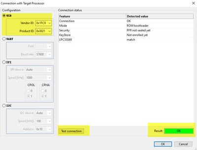

Then, click "Target->Connection" to open the connection configuration.
In configuration, select USB interface, click “Test Connection” button, if the result shows " ok", connected successfully.

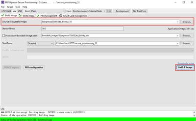

4Select the source file in "Source executable image". This tool can build plaint image, signed image, and encrypted image. You can configure it according to your own requirements. For example, use a plain image file "lpcxpresso55s69_gpio_led_output.hex", this file is a binary file generated from MCUXpresso IDE under the SDK example.
Click the "Build image" button, ensure that the compilation was successful.

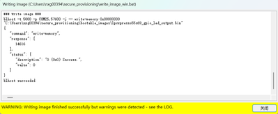

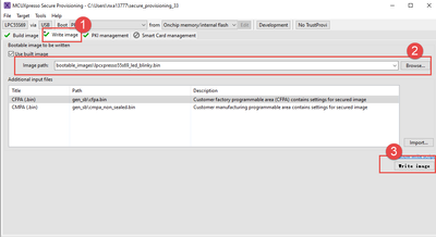

5Download the image file
Choose “Write Image” view, in “Image path” select the image generated by the previous step, then click  “Write Image” button.
If download  successfully, the following picture will be displayed:

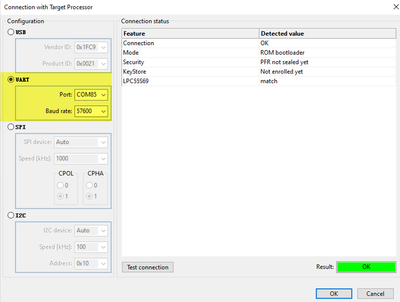

3.2 UART ISP mode
1LPC55(s)xx  use UART0 as UART-ISP interface, you can use USB cable to connect P6 of LPCxpresso55s69-evk and PC, or use USB-UART convertor to connect UART0 TX/RX and PC.
2Enter ISP mode, refer to 3.1.
3Configure MCUXpresso Secure Provisioning Tool, refer to 3.1, select UART connection mode, and perform connection test.

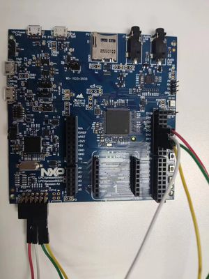

(1) LPC55(s) 2x/6x currently includes two versions, 0A and 1B, which can be checked from the chip mask. The 0A version supports SPI3 and HS_SPI ISP interface, and the 1B version only supports HS_SPI ISP interface. This article uses version 1B for the experiment.
Both SPI and I2C use LIBUSB interface, LPC-LINK2 and MCU-LINK pro support this function interface, so as long as there is LPC-LINK2 or MCU-LINK pro, SPI-ISP and SEC tool connection can be realized. Special reminder: LPC-link2 and MCU-LINK pro must be updated to CMSIS-DAP debugging interface, J-link does not support this function.
In the LPCxpresso55s69-evk development board, SPI3 is connected to LPC-LINK2 by default, and HS_SPI is not connected, so  an external connection is required, connect SCK, MOSI, MISO, and SSEL1 of HS_SPI to the corresponding positions of LPC-link2. For details, please refer to the lpc55xx manual and the development board schematic. It can also be connected according to the figure below.
The connection of the development board is shown in the below picture
