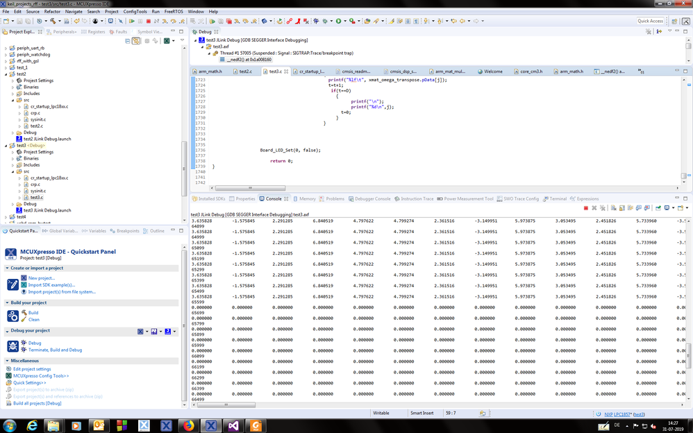

Hi.
I am using the CMSIS DSP library for multiplying two matrices on the keil mcb 1800 board using MCU Xpresso IDE. I am using the external SDRAM of 16 MB for storing the result.
Matrix "xmat" is 1604*8 and omega_transpose is of size 8*100.....Thus the resulting matrix is of size 1604*100.
I am printing the resulting matrix. I am also printing the row number each time and I find that at 65599 the result becomes 0.00000.
Can someone tell me why this is happening and how to solve it?
Please find attached the screenshot of the error and the code (test3.c).

I want to isolate the issue, could you please try with smaller dimensions of the matrix. I want to check if the is a RAM issue.  Check the linker map file for the RAM used by the variables.

I tried to store a matrix of size 11958*8 in the SDRAM and tried to read it.
I find that the 0.000 starts at elemnt 12831 now.
Please see the attached image. What is the real problem?

Seems to be a problem with available RAM. You need to check the linker map file for the RAM used and then play with the heap size.
