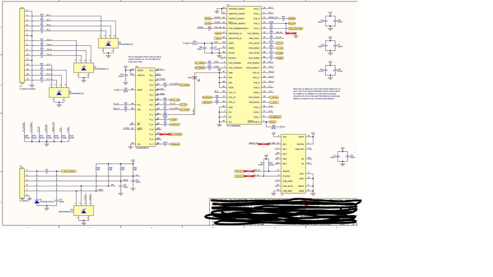

NXP LPC11E68JBD48E Microcontroller I2C1 is Master.   I2C1 is in Master Transmitter Mode.
I2C1 peripheral is in chapter 13.  http://www.mouser.com/ds/2/302/UM10732-315822.pdf
NXP PCAL6416A I2C 16-bit I/O Expander is Slave. https://www.nxp.com/docs/en/data-sheet/PCAL6416A.pdf.
Master reads one byte from slave port 0.  On one board all Eight bits are logic 1's as expected.  On the other board Seven bits are logic 1's as expected
but bit 2 is logic 0.  The input pin connected to bit 2 is pulled up to 3.3V but it's logic 0 on I2C data bus.  Why?
                              D7 D6 D5 D4 D3 D2 D1 D0
Expected              1    1    1    1    1    1   1    1
One board           1    1    1    1    1    1   1    1
Another board    1    1    1    1    1    0   1    1
Explanation/Questions on attached scope screenshots:  Master sends slave address 0100 001(A6-A0), followed by write bit(logic 0).  Slave responds with ACK(logic 0).
Then, master send command byte 0x00(read byte from Input port 0).
Master sends start bit, followed by slave address, followed by read bit(logic 1).  Slave sends ACK.
On one board, slave send 0xFF as expected.  On other board, slave sends 0xFB, not expected. Master follow with a NAK.  Slave pulls data bus low before the stop
condition?  Why slave pulls data bus low?
The primary question is why is bit 2 logic 0 on the I2C bus when it's pulled up to 3.3V ?
Are we setting the I2C device properly?
INT pin(active low) is floating.

In my opinion this is a harward issue, please add pull-up external resistors and check the signals with an oscilloscope.

Are you using an NXP board?
Could you please share the connections you are using?
Are you using external pull-up resistors?
Are you using LPCOpen?
Soledad
4,877 Views
anaseem
This code base has XPRESSO_BOARD compile time flags.  So, previously we were probably using NXP board.
No, we're not using external pull-up resistors on I2C port.  But we're using internal pull-up resistors.  Please review my settings of enabling and pulling up unused inputs on I2C port.

Please note Port 0 bit 2 is correct value on SDA bus on One board but incorrect on different board.
