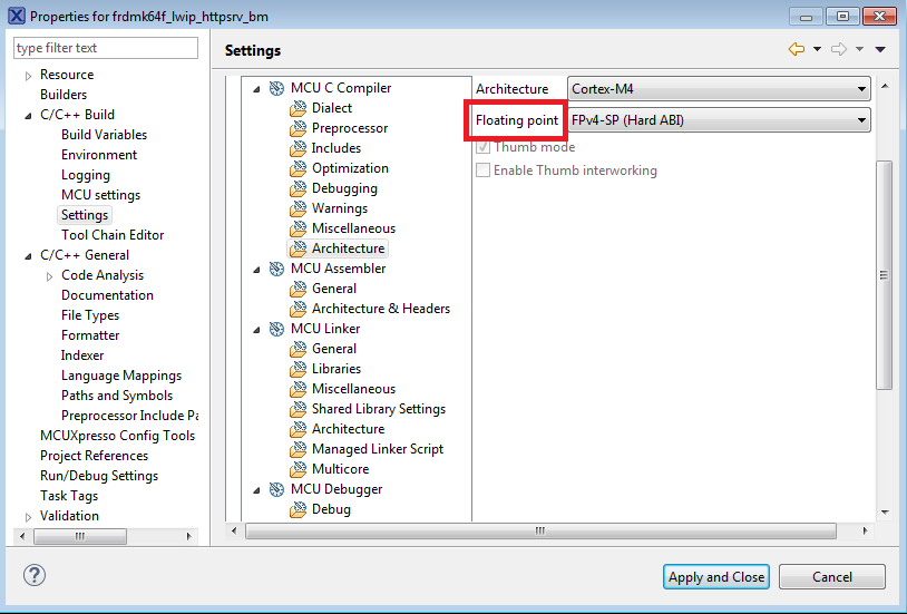

In addition to the step fromUsing CMSIS-DSP with MCUXpresso SDK and IDE please add
#define __FPU_PRESENT                  1         /**< Defines if an FPU is present or not */
 in core_cm4.h,and in  IDE perspective select the following settings:
