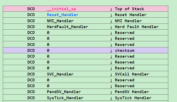

Flash a hex-file in-circuit into a LPC812 I use flash magic with an ISP serial interface or i use J-flash with a SWD interface. With these tools we have no problems.
In the production run we use Beeprog2 from elnec. After programming de LPC812 doesn't boot. The same hex-file is used. After programming I see that the flash in the LPC812 is not identical to the data in de .hex-file. Both flash-magic and J-flash change the data in the first row of 64 bytes.
The first 64-bits in the hex file is:
 :40000000E80400106901000079010000710100000000000000000000000000000000000000000000000000000000000073010000000000000000000075010000770100000C
The first 64-bits in the flash of the LPC812 is:
:40000000E8040010690100007901000071010000000000000000000000000000C5F6FFEF000000000000000000000000730100000000000000000000750100007701000063
The red part is different and is missing when using the Elnec program tool. I wonder what these bytes mean and why flash magic and j-flash load these files into the flash.

Hi, N Kremers,
    C5F6FFEF is the vector 7 in the NVIC, each vector have 4 bytes, vector 7 is the checksum complement data of vector0 to vector6, just like the following picture:
     This checksum complement data normally calculated by the development tools, and write to the chip.
     This is why you will find the vector 7 (checksum) data is different as the original data.
     If you use Beeprog2 , and can't boot, you can contact with elnec, whether you forget some operation step, we don't have this tool on our side.
Wish it helps you!
Kerry
