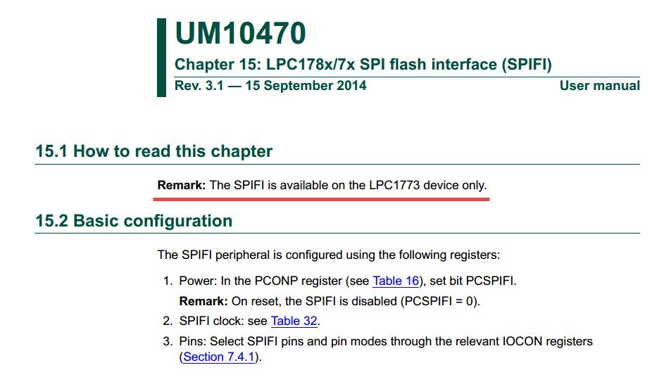

And, tell me, the function described in the file from NXP lpc177x_8x_ssp.c
uint16_t SSP_ReceiveData(LPC_SSP_TypeDef* SSPx)
Will it read the data in the size described in the settings SPI, or will it always return a 16-bit value?

jeremyzhou
Hi Alex Kovtun ,
Thanks for your reply and let me clarify it.
The LPC1788 hasn't the SPIFI module which is different with the SSP interface, in a word, you can run the code in the external flash via the SSP interface.
About the uint16_t SSP_ReceiveData(LPC_SSP_TypeDef* SSPx), I was wondering if you can exemplify the completely codes.

alexkovtun
uint16_t SSP_ReceiveData(LPC_SSP_TypeDef* SSPx)   {
return ((uint16_t) (SSP_DR_BITMASK(SSPx->DR)));   }
I created code to run from external SSP(SPI) flash.
SPIFI memory mapped access space 0x2800 0000 - 0x28FF FFFF (UM10470, page 15)
What memory access space should I specify for SSP?

jeremyzhou
Hi Alex Kovtun,
1) What memory access space should I specify for SSP?
No, because the SSP interface can't access or utilize the QSPI device, and for the LPC178x/7x series, the SPIFI is available on the LPC1773 device only, in another word, the LPC1788 hasn't this address range.

alexkovtun
We are talking about the SSP interface. The range for SPIFI is listed as an example!
I will repeat the question: what memory space can I use for SSP?
