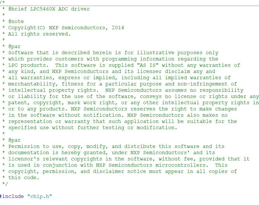

as I wrote, the NXP supplied LPCOpen for LPC5460x devices are already included in Keil products.
Does your statement mean that this will be obsoleted ????
I find this very disturbing, we have been using NXP devices for many years (and hence LPCOpen), so now youre telling us that this will end and you will head in another direction ?!?
I really think that you are about to make a mess of what has been working fine for years for many people :smileysad:

until you get an answer from NXP...I got LPCOpen for the 54x series from my Keil installation:
C:\Keil_v5\ARM\Pack\Keil\LPC54000_DFP\2.2.0\LPCOpen\lpc5460x\
If you are using Keil or not I don't know, so maybe this will not help you at all....
