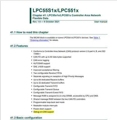

What is the use of this "Debug on CAN support"?Does this feature mean that SWD commands can be executed via CAN?
2,079 Views
ZhangJennie
Where did you see these words "Debug on CAN support"?
Please let me know more information so that I can check it further. Thanks !
Have a nice day
Jun Zhang
2,077 Views
1318614689
I saw it at UM11295.

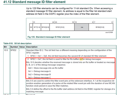

ZhangJennie
Thanks.
This means the CAN module can send data to debug module.
For example, in standard message ID filter element, we can set bits 10:9 to decide the received message to debug message sequence.
