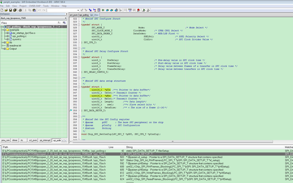

I copied some SPI functions from a project to another. I got a warning related to type mismatch that brought me to the below declaration in spi_15xx.h. Indeed, pTx and pRx are pointers to either 8 or 16-bit data. As the 'source' project had the FE_MOD symbol defined, I just defined it in the current one. I'm just wondering (as I couldn't find any documentation) what other things could this affect.
#ifndef FE_MOD
typedef struct {
uint16_t *pTx; /**< Pointer to data buffer*/
uint32_t TxCnt;/* Transmit Counter */
uint16_t *pRx; /**< Pointer to data buffer*/
uint32_t RxCnt;/* Transmit Counter */
uint32_t Length; /**< Data Length*/
uint32_t ssel; /**< Slave select bits */
uint16_t DataSize; /** < The size of a frame (1-16)*/
} SPI_DATA_SETUP_T;
#else // FE_MOD
typedef struct {
uint8_t *pTx; /**< Pointer to data buffer*/
uint8_t *pRx; /**< Pointer to data buffer*/
} SPI_DATA_SETUP_T;
#endif // FE_MOD

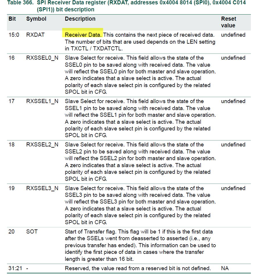

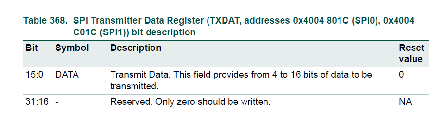

    But, just as you said, pTx and pRx are pointers to either 8 or 16-bit data.
    Actually, you can refer to your own chip, it seems you are using LPC15XX, from the user manual of LPC15xx, we can get that the SPI Receive Data and SPI Transmit Data  useful data is 16 bits.
So, I think you can don't care about FE_MOD, just defined it as :

kerryzhou
Hi Juan,
   Please give me your lpcopen full name, because I didn't find the FE_MOD keyword in my lpcopen version.
Kerry
