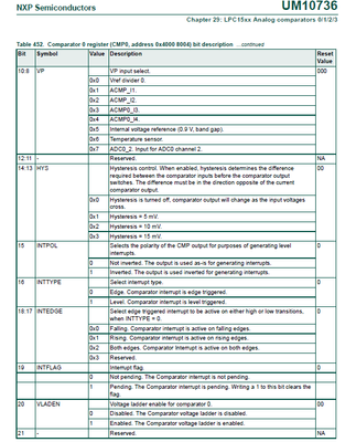

xiangjun_rong
Hi, Benton,
I am curious why you use so large bypass capacitor on the power supply pin, generally, it is okay to use 20uF, 30uF...
If your application does require the large capacitor for special purpose, it is okay.
In the case, I suggest you use comparator interrupt to trigger an interrupt, in the ISR of comparator, you can start to call ADC function so that ADC runs after the power supply voltage reaches a predefined level. I think it is okay also to use polling mode by polling the INTFLAG bit.
Hope it can help you
XiangJun Rong

xiangjun_rong
Hi, Benton,
Okay, I see your application. Pls use the on-chip comparator, you can configure the comparator so that it can set the STAT and INTFLAG bits in the Comparator x register, in the initializing code, you can poll the flag bit, after the flag bit is set, start ADC.
XiangJun rong

ianbenton
Senior Contributor I
Unfortunately, it’s not just the a/d that can fail to start - so can the comparator.
The comparator routine ensures a good start up about 95% of the time, but it can still fail.
Enabling the watchdog forces a hard reset if it gets stuck in the “wait for comparator” routine, and it has another go.
For good measure, I also enabled the brownout detect.
Now I think it’s reliable - or, any remaining bugs are down to my writing rubbish software, not due to the hardware failing to start up!
