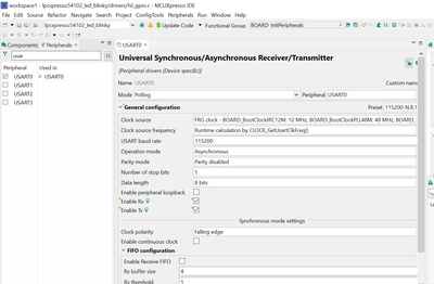

I'm trying to get my MCU to communicate with my computer via a COM port, but so far, I've had no luck. My setup includes the MCUXpresso IDE, where I've activated the RX and TX pins. Additionally, I've configured USART communication, which resulted in the following configuration:
const usart_config_t USART0_config = {
.baudRate_Bps = 115200UL,
.syncMode = kUSART_SyncModeDisabled,
.parityMode = kUSART_ParityDisabled,
.stopBitCount = kUSART_OneStopBit,
.bitCountPerChar = kUSART_8BitsPerChar,
.loopback = false,
.enableRx = true,
.enableTx = true,
.clockPolarity = kUSART_RxSampleOnFallingEdge,
.enableContinuousSCLK = false,
.fifoConfig = {
.enableRxFifo = false,
.rxFifoSize = 4U,
.rxFifoThreshold = 1U,
.enableTxFifo = true,
.txFifoSize = 4U,
.txFifoThreshold = 0U
static void USART0_init(void) {
// USART0 peripheral initialization
USART_Init(USART0_PERIPHERAL, &USART0_config, USART0_CLOCK_SOURCE);

Hello @mimers19
1) Firstly recommend you use debugger to debug your code, not directly program .hex file to run. Debug step by step to check issue.
2) You can use Config tool inside MCUXpresso IDE to configure USART_0:
3) Also can refer to UART SDK demo under LPC54102 .
