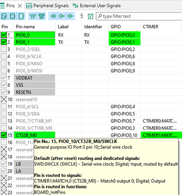

I'm reasonably new to MCU Expresso and LPC8 family.
I was using CTIMER1 on my LPC8N04 and routed the match0 pin to SWCLK, thinking that the 'do nothing' selection might not do anything. I'm using the LPC8N04 dev board OM40002.
I immediately lost debug, and the probe can't speak with the target at all. MCU Expresso is giving me error after error.
I fear I've bricked the dev board. How do I get it back?

Just to confirm, this is ALL I did to cause the issue. Simply CTIMER1 Match routed to pin 15 SWDIO.

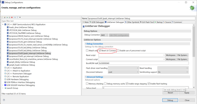

xiangjun_rong
As Erich said that the Prob has to capture the device before the application code assigns the PIO0_10/CT32B_M0/SWCLK as function CT32B_M0.
Because the LPC8N04 does not have ISP mode, it deteriorates the scenario, you can not have the pins in the default state.
But I think the key is the prob can capture the device before the application code execute the line to configure the PIO0_10/CT32B_M0/SWCLK after Reset. So you can set up the prob so that it can capture the device as soon as possible after Reset.
1)Pls try to check the box of Reset on connect
2)pls try to press Reset button on the board and and press "Debug"  to download application immediately, and try multiple times and check if you have opportunity.

I don't agree that this is a design flaw: this is by design and purpose, as that way you have more pins available, and in the case you need to protect against debug access to you IP and board, it is standard procedure to disable the debug pins, even inside the boot ROM. And your screenshot below should already have informed you that you are going to affect the SWDCLK (not the SWDIO)?
