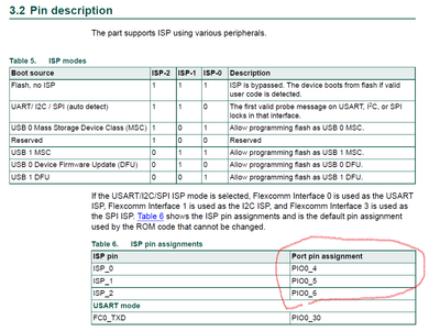

I switched to LPC54605J512 MCU because of its performance.
However, the program doesn't start automatically after power recycling. I need to reprogram the MCU to make the SW start execution.
The RST pin is linked to VCC and I use Keil as a development environment.

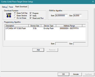

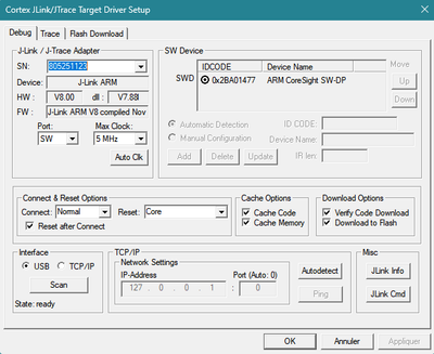

Below you will find the programming jlink configuration screenshots.

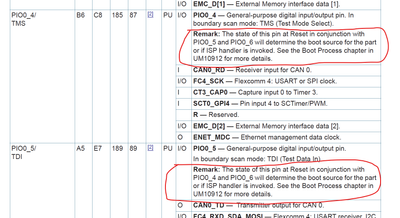

If you want to LPC54605 to run from internal flash after power on, you have to set the three pins PIO0_4, PIO0_5 and PIO0_6 pins high logic by connecting a pull-up resistor on the three PIO0_4, PIO0_5 and PIO0_6 pins so that the chip will fetch/execute code from internal flash after power-on.

And another question about the programming, when I used LPC845, Normal reset was enough to make the chip run the main program after flashing, but I need absolutely select Core Reset for LPC54605. Any feedback?
Also, when I use Segger RTT viewer connected, I can't flash the chip, however, it was possible when I used LPC845.
Thanks again for your valuable feedback.

Pls refer to section 13.3 Connecting power, clocks, and debug functions in data sheet of LPC546xx, which can be downloaded from the website:
https://www.nxp.com/products/processors-and-microcontrollers/arm-microcontrollers/general-purpose-mc...
BTW, pls refer to the section 6.2.1 Termination of unused pins in the data sheet.
