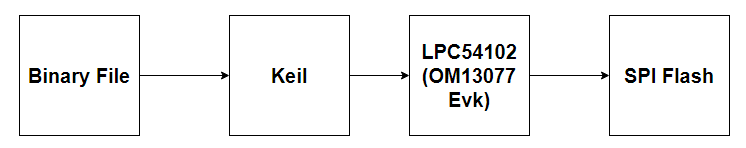

I'm wondering if there's a way to load a random binary file into external SPI flash using Keil. The binary file will pass through the LPC54102 (OM13077 EVK board). I know some ISEs for FPGAs allow you to do this, curious if this is possible with the LPC54102 using Keil.
Obviously Keil will need to know what SPI flash is connected to the LPC, along with other details like, SPI port, clk speed, etc.
Does anyone know is Keil can do this?

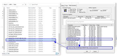

-  1. If the default selected Flash download algorithm file is not applicable to your board, then you need to provide a suitable algorithm file (.FLM) yourself and place it in the MDK installation directory (\Keil_v5\ARM\Flash). Then, reopen the project options, and the newly added algorithm will be automatically refreshed into the list of selectable algorithms.
2. After obtaining the appropriate download algorithm file, you finally need to check two address ranges. One is the actual mapped address space corresponding to the Flash, and the other is the running RAM address space of the download algorithm file.

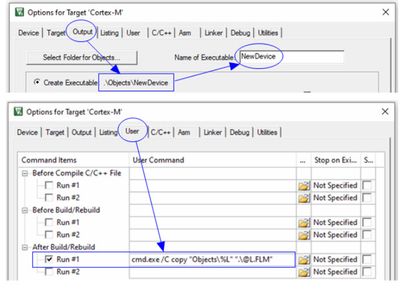

After obtaining the basic template project, we need to change the default ARMCM0 core in the project options according to the type of the target MCU core. Then, we need to implement all the algorithm API functions in FlashDev.c and FlashPrg.c (they are empty by default). Finally, compile the project to generate the.FLM file, which is the algorithm file we need (in fact, the final.FLM file is obtained by directly renaming the.axf file through the script command in After Build. The.FLM file is essentially an axf format file).

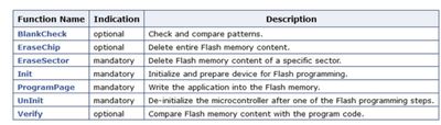

In addition to FlashDevice, the most core part is of course the seven API functions in FlashPrg.c. These API functions provide the actual functions of Flash erasing, programming, and verification. The IDE will automatically call these APIs as needed to achieve online downloading. The prototypes of these APIs are fixed, but the specific function implementations vary depending on the board.

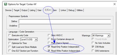

There is also a design of the algorithm project that has to be mentioned, that is, both Read-Only Position Independent and Read-Write Position Independent are checked under the project options C/C++ (including Asm). This indicates that the download algorithm itself is not linked using a fixed address, but is a position-independent link (also called a relative address link). The machine code of the algorithm code can be executed at any address, which is why you can specify the RAM for Algorithm in the example options.
