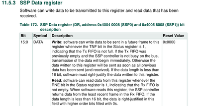

Hello @sai-t
If you send 0x03, yet the signal detected on the analyzer shows 0x06, you should first check the Data register (DR).
Alice

sai-t
Hi Alice_Yang, Thanks for your help. I have gone through the code and tried it in my project. But when I am trying to use those functions the BSY bit is continuously getting HIGH and getting struct in the while condition. And because of that I am unable to store the response that is coming from the MISO line. The same DR register is used for the transmission and the receiver. Can you help me how to resolve this issue.
