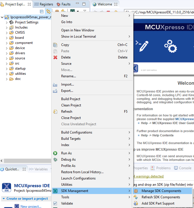

I'd recommend taking a look at Section 8.3 of the reference manual as it describes the configuration options for the clocks. In addition you can also use the exaple provided in the demos of the SDK to view power_mode_switch_lpc. in this case you will see the different APIs used to configure what is stated in section 8.3.
If you are creating your own code you can add the clock drivers manually to your project by doing the following:
1. Select your project and right click.
2. Select SDK Management and Manage SDK Components
3. Select the drivers tab and make sure that clock is selected.
In the case of the example I described, they use BOARD_BootClockPll24M(); From here you could divide the clock by 2 to achieve the 12M.

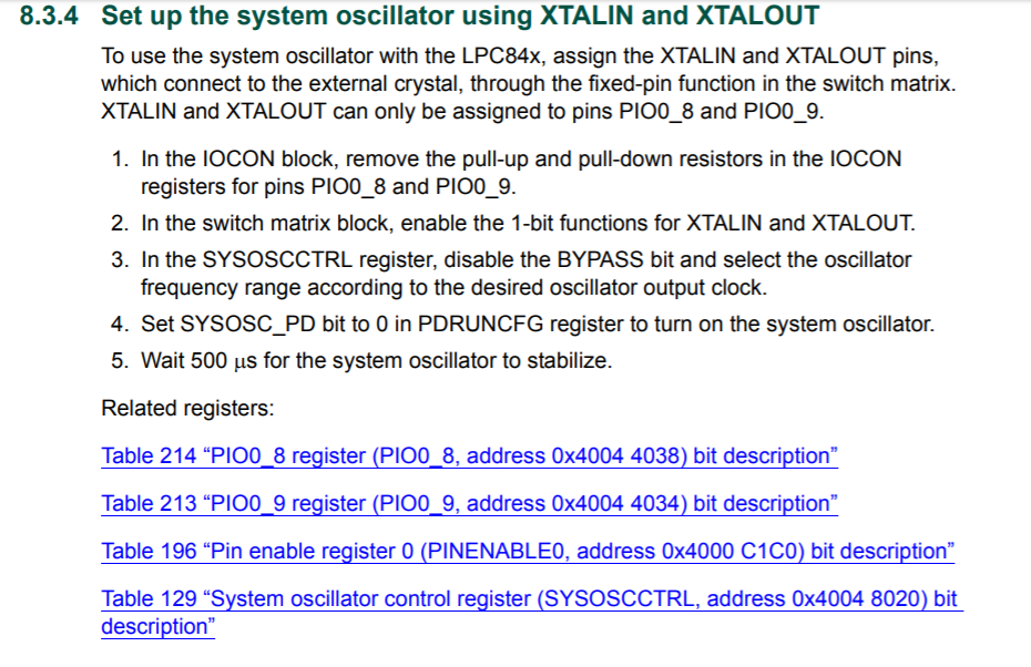

We are trying to use external crystal clock of 12cMhz, so do we need to initialise the xtal1 and xtal2 pins?
referred user manual, and tried activating the crystals, but the external crystal of 12Mhz connected to the
prototype board is not working, is there any registers need to be set ?

In order to used the external oscillators, you need to configure it as so:
In the reference manual the links are provided for each register that are mentioned in the list above. The one called "pin enable register 0", is the switch matrix block, you will find the bits for XTALIN and XTALOUT to be 7 & 8.
Please let me know if you have further questions.
