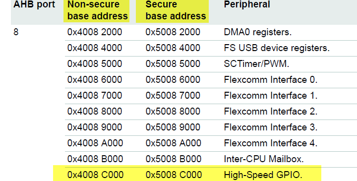

Hello Eugene Hiihtaja,
From your description , I think your requirement is not SGPIO function,
it should be TrustZone . The implementation of ARM TrustZone for CPU0 involves using address bit 28 to divide the address space into potential secure and non-secure regions.
In Table 5 of UM,  provides details of the addresses for APB peripherals. APB peripherals have both secure and non-secure access possibilities.
So we can only set the whole GPIO to secure space or Non-secure, can't split GPIO0 pins for Secure and Nonsecure groups.

EugeneHiihtaja
Senior Contributor I
Hello!
But I can see separate peripheral called  HS Secure GPIO. I assume some individual pins start to belong to Secure GPIO and controlled from secure world and remains one can be controlled via NonSecure world by using GPIO peripherals.
And TZ configuration will be done accordingly.
Also GPIO releated to peripherals will be added to Secure domain for avoid any read from NonSecure side.
Or how it works ?

Hello Eugene,
OK, I know your meaning.
Yes, you can set some of the GPIO as secure GPIO, some as normal GPIO.
About how to config them as secure GPIO, please refer to the AN12326 I mentioned before.
And also there is Secure GPIO demo under SDK, this demo just config one pin as Secure GPIO.
