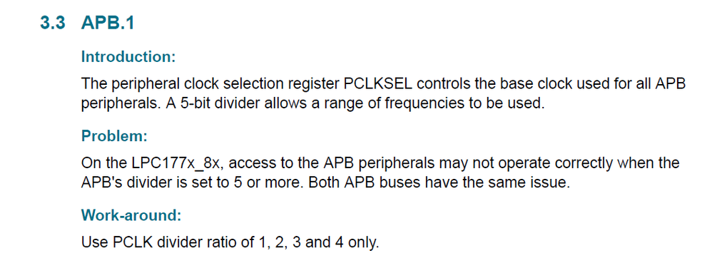

Friedbert,
I don't know if this relates to your problem or not (you probably already have seen it) but just wanted to mention it anyway as this exact errata/error has caused me some headache of various kinds when dealing with LPC177x systems....The PCLK divider must only be 1,2,3 or 4. Doing anything higher than 4 will give you some VERY interesting failures of the various peripherals inside the chip. Just as a heads-up
