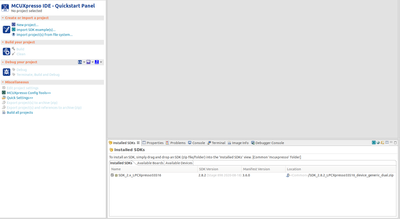

I've tried to load this SDK to MCUXpresso without success.
I have installed the SDK:
Then I clicked at "Import SDK example(s)" and could not find the dual USB one.

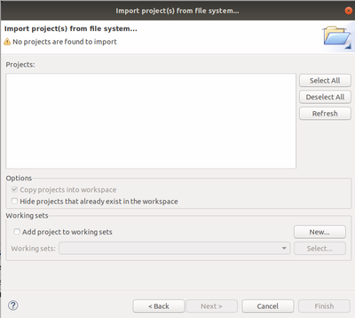

I also tried to click at "Import project(s) from file system" and select the SDK, but the "Projects" field is empty.
How can I flash this Project to my board? and how can I modify the code?

ZhangJennie
This demo is for Keil and IAR. It doesn't support MCUXpresso IDE.
