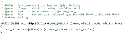

Harry_Zhang
@pranavkolte
1. Abort "how to configure the CLK2 pin"
You can config clock2 pin through Chip_SCU_ClockPinMux function.
2. About "set the clock frequency to 1MHz"
You can config clock through blow functions
Chip_Clock_SetDivider();
Chip_Clock_SetBaseClock();
Chip_Clock_EnableBaseClock();
Or you can download and refer to LPC 18XX examples.
LPCOpen Software for LPC18XX | NXP Semiconductors
Hope this will help you.
Hang

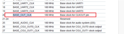

Harry_Zhang
Hi @pranavkolte
You need to configure the Clock Output (CLKOUT) feature correctly. Below are the steps you can follow to achieve this:
1. **Configure the Clock Output Pin:**
Ensure that the CLKOUT function is configured on the appropriate pin (typically this is a specific pin that can be multiplexed to CLKOUT). .
2. **Set the CLKOUT Configuration Register:**
Use the appropriate registers to set the clock source for CLKOUT.
Step-by-Step Guide
1. **Enable the Clock Output Pin:**
Configure the pin function using the IOCON register.
2. **Configure the CLKOUT Source:**
Select the clock source and divider for the CLKOUT. This involves writing to the CLKOUTCFG register. The CLKOUTCFG register controls the clock source and the divider for the CLKOUT pin.
3. **Enable the Clock Output Function:**
Ensure that the clock output function is enabled.
Hang
2,635 Views
pranavkolte
Hello @Harry_Zhang
Thank you for the guidance, I tried it and able to see the frequency now. Can please let me know about how can I set the clock frequency to 1MHz and how to configure the CLK2 to see 1 MHz or send me any example code to do so.

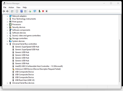

pranavkolte
Hello @Harry_Zhang
Can you please help or guide me with how can I use tinyusb with my project but I do not want to use the board files . I just want the device should be displayed in device manager, till now what ever I have done it shows this in device manager.
DeviceDescriptorRequestFailed.png.
It will be helpful if you can share a code or project of that.
