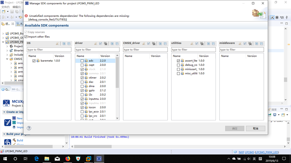

mjx1995mjx
Hi Sabina,
     Thanks for your help.I followed your advise but not work.I delete the fsl_ctimer.h and fsl_ctimer.c from the driver folder, then I found  SDK management tool and selected ctimer, an error shown this.
   So I selected debug_console_lite, added files and built project.
   Unfortunately the error still exist.
Thanks for your patience.
Peter
