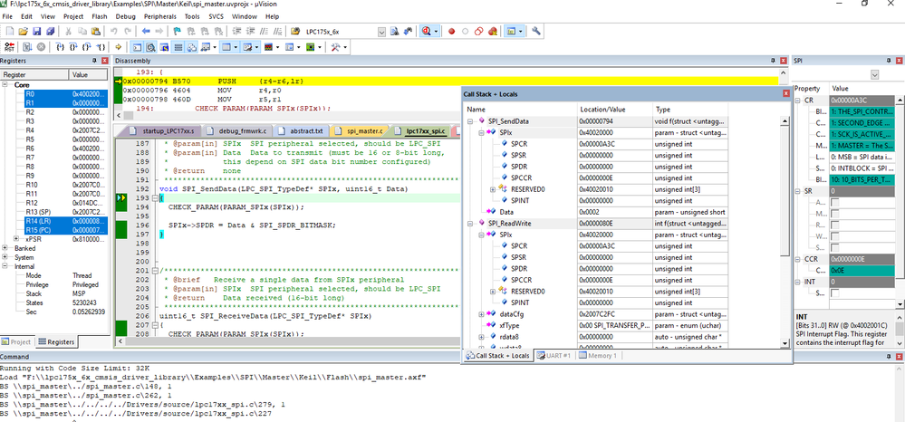

I am debugging the example code of lpc17xx SPI master.
Problem: data is not copying in the SPDR data registor.

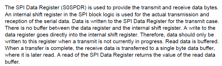

Hello rewatee poonia,
In SPI model of LPC17xx, there is no buffer between the data register and the internal shift register. A write to the
data register goes directly into the internal shift register, so we can not read the send data in SPI Data Register (S0SPDR).
The SPI Data Register (S0SPDR) is used to provide the transmit and receive data bytes, Read data is buffered.
When a transfer is complete, the receive data is transferred to a single byte data buffer, where it is later read. A read of the SPI Data Register returns the value of the read data buffer.
About the detail you also can have a look at User manual of your chip , the SPI part:

rewatee_poonia
Hello   Alice_Yang
I have tried the SPI example with Open LPC1768(Master) microcontroller and Arduino Mega 2560(Slave).
problem: The data is not getting at the slave arduino.
I have tried the SPI communication between two arduino mega(MASTER & SLAVE). In that case SPDR is updating. Whatever data i am sending from master, it is getting receive at slave device.
** In case of open LPC1768  it is not working. I am receiving 0 at slave.
SPI master code (Example code from cmsis library)
I did some changes in spi_master.c
1. mode 0->CPHA  & CPOL =0
      SPI_ConfigStruct.CPHA = SPI_CPHA_FIRST;
      SPI_ConfigStruct.CPOL = SPI_CPOL_HI;
2.    #define SPI_DATABIT_SIZE    8

Hello rewatee ,
First of all , we should confirm  there is right output signal on MOSI of LPC1768,  Please use logic analyzer check it .
2,997 Views
rewatee_poonia
HelloAlice_Yang
I have checked. There is no data available on MOSI pin and clock pin.
