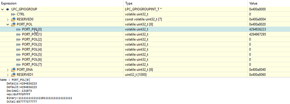

Sorry for my late answer, but here are the results of my tests:
In case of pin 0.17:
 Chip_Clock_EnablePeriphClock(SYSCTL_CLOCK_GPIO2);
 Chip_Clock_EnablePeriphClock(SYSCTL_CLOCK_GPIO0);
 Chip_GPIOGP_Init(LPC_GPIOGROUP);
 Chip_IOCON_PinMuxSet(LPC_IOCON, 0, 17, (IOCON_DIGMODE_EN | IOCON_MODE_INACT) );;
 Chip_GPIO_SetPinDIRInput(LPC_GPIO, 0, 17);
 #define TEST_BUTTON_PIN 17 /* GPIO pin number mapped to PININT */
 #define TEST_BUTTON_PORT 0 /* GPIO port number mapped to PININT */
  Chip_GPIOGP_SelectLowLevel(LPC_GPIOGROUP, 0, TEST_BUTTON_PORT, 1 << TEST_BUTTON_PIN);
Result:
And indeed the pin polarity is set correctly.

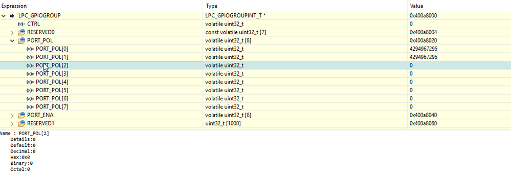

In case of pin 2.4:
But now the whole register stays 0 (POL[0] and POL[1] are both Binary:11111111111111111111111111111111)
I am confused, the only conclusion I can make is that this whole thing does not work for Port 2.
Greetings Marco

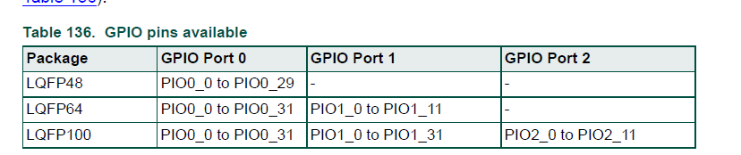

Hello Marco Kuystermans
Please check how many pins in your chip refer to Data sheet, or you can tell me the part number , I help you check it.
If 48 pins or 64 pins, there isn't GPIO port 2, only 100 pin chip have:
Hope it helps,
TIC

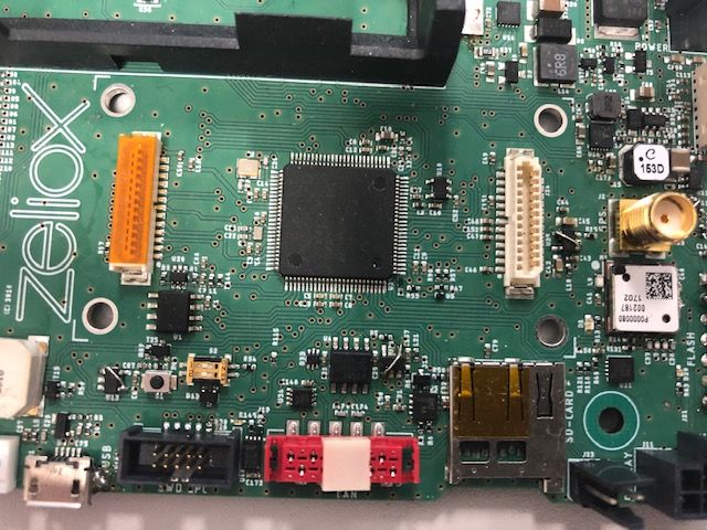

marcokuysterman
Alice,
good thinking, but I am using the LPC1549JBD100 which is a 100 pin device.IMG_5491.jpg
Greetings, Marco
