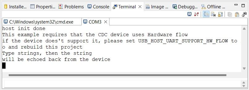

I am very new to this and am simply trying to correctly run the lpcxpresso55s36_host_cdc_bm example for the LPC5536-EVK board I am using.
I currently have a USB cable plugged into J1 from my PC to provide power, and after building and running the example (and opening the COM port), the following shows up in the terminal:
This looked like a good sign, but when I tried to plug in a USB drive (into either J2 or J3), there wouldn't be any indication that it's connected. According to the readme.pdf, the console is supposed to look like this.
Could anybody point me in the direction of what I'm missing? Are there perhaps jumpers that I don't know about that need to be connected, the USB formatted in a certain way, or other settings that need to be adjusted in my workspace?

Apologies, it makes more sense for me to use the lpcxpresso55s36_host_msd_command_bm example. I still get the same issue. The COM port states that 'host init is done' but doesn't show anything else after the flash drive is inserted into the usb port.

Please read these threads:
Link1
Link2
According to those posts, you need another board as a device_cdc for test.
