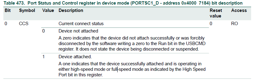

nagendramurthy
As you suggest a has following the steps from USB example to develop my code.
Now i have again facing problems. i'm using CMSIS driver to develop the code.
following are the header file been used.
#include "Driver_USBD.h"
#include "rl_usb.h"
#include "usbd_config.h"
#include "usb_def.h"
code is error free.
CCS bit in the USB register (PORTSC1_D) is not getting set. can you tell be how this bit is set.
in the data sheet it is mention that this bit is read only.
8,620 Views
bernhardfink
The level of information you provide for your setup (hardware, software, compiler etc) is by far not enough (effectively it's near to zero) to give you any hint what you might do wrong.
I can only repeat what I have already said:  take an existing example, run it on a convenient hardware and learn from it.
And by the way:  there is nothing to misunderstand in the CCS bit description of the PORTSC1_D register. This bit is set by when the USB block identified successfully a device attachment.
NXP Support Team
