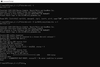

Can you please go to
http://dfu-util.sourceforge.net/
to download the latest DFU tool
DFU update application Steps:
Take LPC54628 as an example, ISP is configured as DUF mode, and USB1 is used to upgrade the application.
  • Modify the relevant code in Figure 3, as follows:
isp_mode[0] = 0xAA; isp_mode[1] = SL_USBHS;
Build and download the application to the MCU, power on again, and connect USB1 to the computer. Here
  • Enter the dfu-util tool directory and copy the .bin file to the current directory.
Use the command: ./dfu-util -l   Find the DFU devices.
Use the command: ./dfu-util -D .\lpcxpresso54628_gpio_led_output.bin -a 0
Download the lpcxpresso54628_gpio_led_output.bin file to the device with alt number 0. Alt0 is "FLASH", alt1 is "RAM", and the specific operations are as follows:
My test result:
Hope this helps.
Jun Zhang

mitchkapa
Please see the screenshot below.  With the latest version of dfu-util I have output that looks more like yours. But I still have errors.  I have highlighted in the image where things appear to diverge between your output and mine.  Do you have an LPCXpresso54018 eval board where you can attempt this procedure?  I would like to make sure that my different processor is not the cause of the problem.
Can you also step through the procedure for making the proper binary file for usage with DFU?  How dfu-prefix and dfu-suffix should be used?  And my initial binary I am creating from a .axf file using the IDE Binary Utilities tools.  Is that the correct procedure? dfu-util_output.pngdfu-util_output.png

ZhangJennie
I test it with LPCXpresso54S018 board, there is no issue
Please note, as LPC54(s)018 doesn't have on chip flash, DFU can only download it to SRAM
Jun Zhang

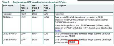

bin file doesn't include address info. we can just generate bin file inside IDE, right click on the generated axf file to generate bin as below:

Thank you very much for your help.  I was finally able to have some success uploading code via DFU.  But I also think I finally understand that for this processor DFU will not be useful for my intended purpose.  I thought DFU would write "through" the SRAM and program the external flash.  But that is not the case?  For the LPC54018 DFU can only be used to load a binary for a single use instance and on the next reboot it will revert back to the original code in external flash.  Do I have that correct?
7,677 Views
ZhangJennie
Yes, your understanding is correct.
If you want to program external spifi Flash, you need to program flashloader to sram via DFU then program spifi flash by flashloader.
