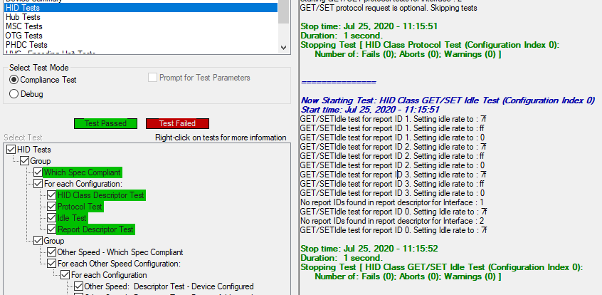

I have recently updated SDK to 2.7.0 for LPC546 in my project and noticed set/get protocol errors during USB CV tests.
The problem is in usb_device_hid.c file
                    case USB_DEVICE_HID_REQUEST_GET_PROTOCOL:
                        /* Get protocol request, classCallback is initialized in classInit of
                           s_UsbDeviceClassInterfaceMap,
                           it is from the second parameter of classInit */
                        error = hidHandle->configStruct->classCallback(
                            (class_handle_t)hidHandle, kUSB_DeviceHidEventGetIdle, &hidHandle->protocol);
                        controlRequest->buffer = &hidHandle->protocol;
                        break;
kUsb_DeviceHidEventGetIdle should be replaced with kUsb_DeviceHidEventGetProtocol.
SDK 2.8.0 also has the same issue.
The second thing I want to pay attention to are these pieces of code.
                    case USB_DEVICE_HID_REQUEST_GET_IDLE:
                        /* Get idle request, classCallback is initialized in classInit of s_UsbDeviceClassInterfaceMap,
                            (class_handle_t)hidHandle, kUSB_DeviceHidEventGetIdle, &hidHandle->idleRate);
                        controlRequest->buffer = &hidHandle->idleRate;
                        break;
                    case USB_DEVICE_HID_REQUEST_SET_IDLE:
                        /* Set idle request */
                            hidHandle->idleRate = (controlRequest->setup->wValue & 0xFF00U) >> 0x08U;
                            /* classCallback is initialized in classInit of s_UsbDeviceClassInterfaceMap,
                                (class_handle_t)hidHandle, kUSB_DeviceHidEventSetIdle, &hidHandle->idleRate);
                        break;
From USB hid spec follows that get/set idle requests can be done to a particular report ID.
Report ID field - If the lower byte of wValue is zero, then the idle rate applies to all input reports generated by the device. When the lower byte of wValue is nonzero, then the idle rate only applies to the Report ID specified by the value of the lower byte.
But the parameters that are passed to a class Callback doesn't give info about the Report ID. Maybe I missing something but seem like this case is not handled properly.

Hi Sabina. Thank you for your answer. But I can't agree with the next 2 statements.
1) Both set and get idle requests are configured that all the idlerate applies to all report IDs.
Yes, and this is not how it should be by USB hid specification.
2) As you may see in the description for both of these requests either the higher or lower byte is 0 which means all report IDs.
This is not correct.
The specification tells that only if the lower byte of wValue is zero, then the idle rate applies to all input
Seem like SDK code assumes that lower byte always is 0, but it's not always true.
In order to fix this, in both cases of set/get idle last argument should be changed
with
                                (class_handle_t)hidHandle, kUSB_DeviceHidEventSetIdle, &controlRequest->setup->wValue);
This will allow set and get idle rate for particular Report Id or to all of them as expected by USB hid spec.

I expect to see wValue in both callbacks, and from there decide how to apply it.
Here is a USB CV example of how the host may behave and set/get different idle rates for different Report Ids.
