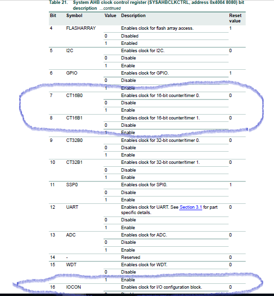

Pls check that you should Enable the IOCON bit before you call the iocon_set_mux(PWM0_IOCON, PWM0_MODE);

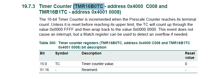

Secondly, after you run the code, then set a break point, and check the Timer counter register TMR16B0TC and check if it is counting.
If it is counting, I think the PWM signal should appear on the pin.
