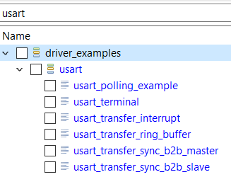

I AM USING LPC804
USING THIS CODE I AM TRYING TO SEND THE CONTINEOUS DATA AND I WANT TO  RECEIVE THE SAME TRANSMITTED DATA IN rxBUFFER. HERE I AM TRANSMITTIND DATA 'A' CONTINEOUSLY AND I WANT RECEIVE THE SAME DATA IN rxBUFFER THAT TOO CONTINEOUSLY. IT WILL BE GREAT IF I GET PROPER CODE AND METHOD .
THANK YOU
1,237 Views
Pavel_Hernandez
Hello, my name is Pavel, and I will be supporting your case, I recommend review the available examples on the SDK, if the issue persist, please let me know.
Select Board | MCUXpresso SDK Builder (nxp.com)
Pavel
