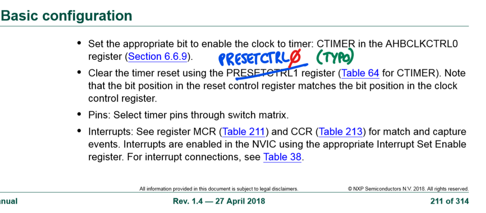

Typo_CTIMER0_UserManual.PNGThe CTIMER section of the user manual for the LPC802 has a typo.  It should be PRESETCTRL0 not 1.  Seems to be confirmed in Table 64, as well as in the lpc802.h header file, so that resetting should look like this, I believe:
    // Reset the CTIMER module via PresetControl 0 register
    // bit is 1 out of reset (cleared reset).  Make it 0, then 1.
    SYSCON->PRESETCTRL0 &= ~(SYSCON_PRESETCTRL0_CTIMER0_RST_N_MASK); // 0
    SYSCON->PRESETCTRL0 |=  (SYSCON_PRESETCTRL0_CTIMER0_RST_N_MASK); // 1

Hi James,
I think you are right. I will escalate it to document to have it fixed.
Thanks you for bringing the problem to our attention.
