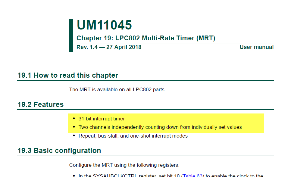

I have found a typo in the User Manual for the LPC802.  The MRT is described as having 4 channels and 24 bits on the timer.  It's actually 2 channels and 31 bits.I chekcTypo_MRT_UserManual.PNG

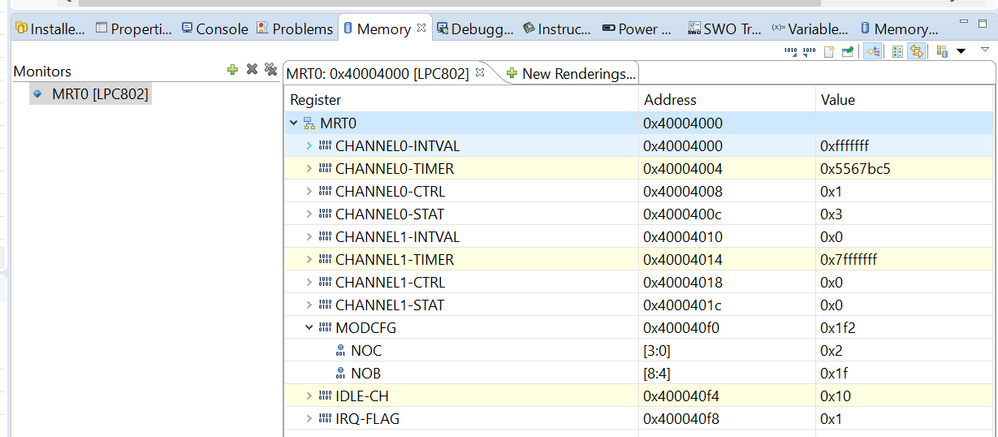

I checked the register value of MODCFG in MCUXpresso just to make sure (see NOC and NOB values).

Hi James.
As documented in user manual MRT is 2 channel 31 bit interrupt timer.
I found the same typo in LPC804 manual. I will report this problem.
Thanks for bringing this two our attention.
