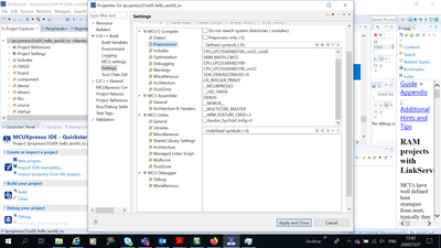

xiangjun_rong
Hi, Lukas,
I am sorry, you have to set the _ARM_FEATURE_CMSE=3 in the compiler option for the non-security world project.
Hope it can help you
XiangJun Rong
