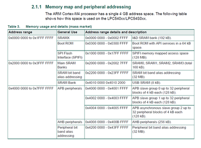

xiangjun_rong
Pls refer to the memory map of LPC546xx in UM11060.pdf, as you see that the base address 0x1000_0000 is spifi flash start address, the 0x2000_0000 is on-chip RAM address, the 0x4000_0000 is peripheral register address.
Hope it can help you
XiangJun Rong

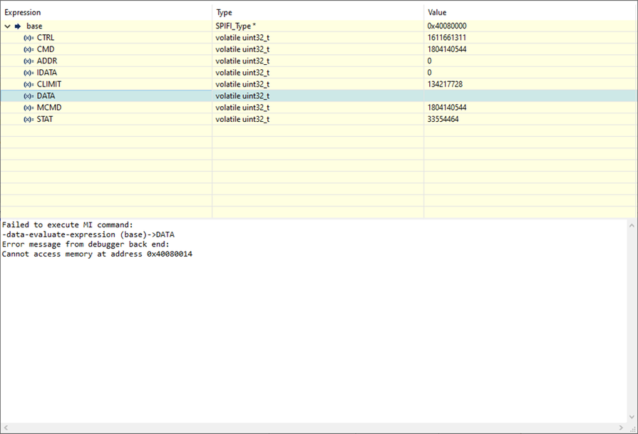

NVazquez
So if I want to write some data in external SPI flash it should be written starting from 0x4000_0000?
Is there a reason why I am getting an error while writing the data buffer and I get that "Failed to execute MI command"? It says cannot access at address 0x40080014 because I have "??" there.
This is what I have set in the code,
/** Peripheral SPIFI0 base address */
#define SPIFI0_BASE (0x40080000u)
This is where I write all the data and command.
/* @brief SPIFI start address */
#define FSL_FEATURE_SPIFI_START_ADDR (0x10000000)
uint8_t *val = (uint8_t *)FSL_FEATURE_SPIFI_START_ADDR;
This is where I read the written data.
I am using the sdk example "SPIFI polling transfer" as it is.
It would be really helpful if you tell me if I am not doing anything right in these definitions or I need to use a different sdk example.
Thank you!

xiangjun_rong
I have to say that the address 0x4000_0000 are peripheral register address, they have special meaning for each register, you can NOT write them as general memory.
For the spifi flash writing example project "spifi_polling_transfer",
/* Write enable */
SPIFI_SetCommand(EXAMPLE_SPIFI, &command[WRITE_ENABLE]);
/* Set address */
SPIFI_SetCommandAddress(EXAMPLE_SPIFI, 0U);
//Rong write:
the address 0 is the external spifi flash offset, it's absolute address is 0x1000_0000 in the ARM core address space, which also save application code, so if your write address, the application code is overwritten. You have to select an offset which does not occupy with application code so that you can put your application data to the space.
For the program part code, it is the same that the address is the offset of external flash rather than absolute address.
/* Erase sector */
SPIFI_SetCommand(EXAMPLE_SPIFI, &command[ERASE_SECTOR]);
/* Check if finished */
check_if_finish();
XiangJun Rong

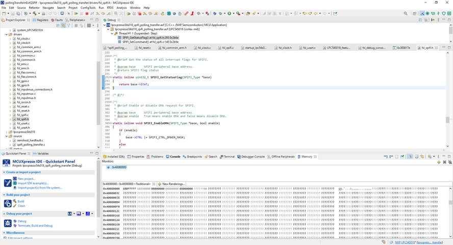

NVazquez
static inline void CLOCK_EnableClock(clock_ip_name_t clk)
uint32_t index = CLK_GATE_ABSTRACT_REG_OFFSET(clk);
if (index < 3UL)
SYSCON->AHBCLKCTRLSET[index] = (1UL << CLK_GATE_ABSTRACT_BITS_SHIFT(clk));
else
SYSCON->ASYNCAPBCTRL = SYSCON_ASYNCAPBCTRL_ENABLE(1);
ASYNC_SYSCON->ASYNCAPBCLKCTRLSET = (1UL << CLK_GATE_ABSTRACT_BITS_SHIFT(clk));
I tried to debug exactly where I get question marks at 40080000 location and it looks like, when I execute this line "SYSCON->AHBCLKCTRLSET[index] = (1UL << CLK_GATE_ABSTRACT_BITS_SHIFT(clk));".
I have a 12Mhz crystal on my board, do I need to make some changes in the sample sdk code?
9,469 Views
NVazquez

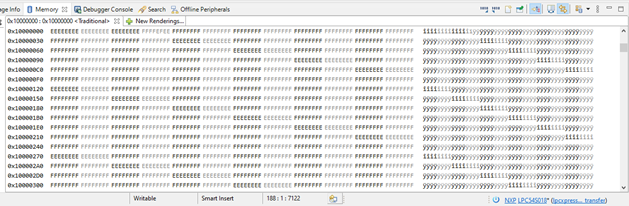

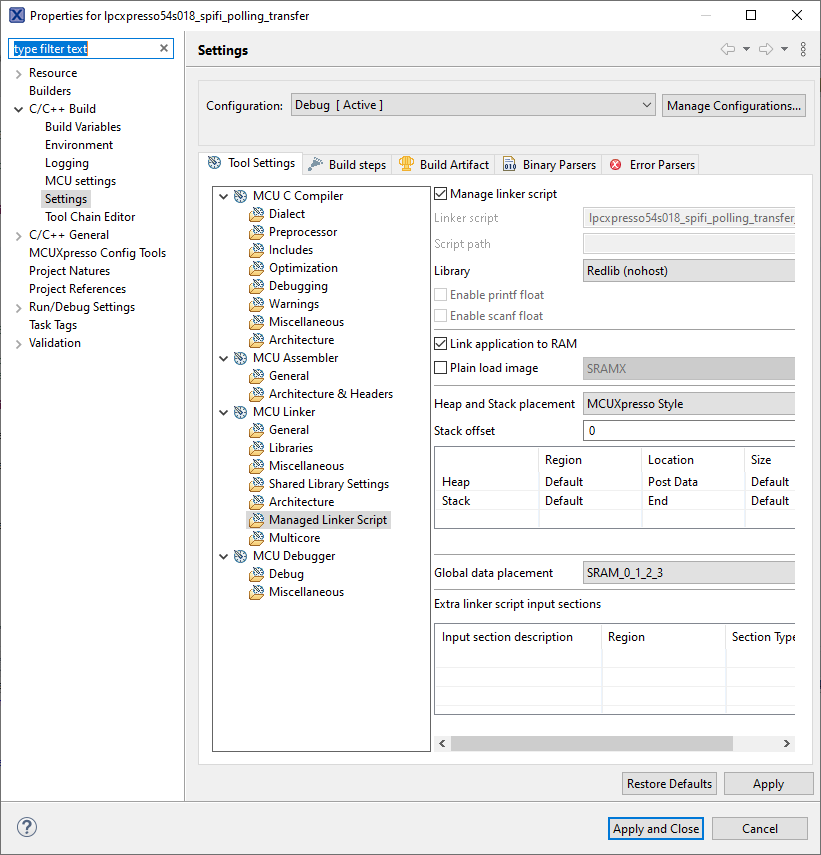

I tried to debug, I think due to some reason my data is not getting written,
 this is what I'm getting.
some screen shots if that's going to help understand my problem,
